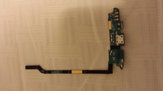

Had a GS4 same error when tying to charge. I replaced this part. Which fixed it. Just thought I would share.
Thankyou Cach 474, I changed it, before, but the issue remains. Just the issue late and less up come.

It's already been given. It appears to be to change the "USB charging board." It sounds like there must be some failure with the temperature sensing circuit on that board.

I've changed my board but still the same issue. It would have to be a sensor issue on the mainboard in this case :(.
Hi I had this problem with my phone but now I have figured out how to fix it. The thermistor ( which is located in the charging port) is faulty and reads a temperature to high or low hence then you can't charge the battery . There are two possible fixes to this problem
1. Replace charging part (costs around ?6.00 from ebay)
2. Buy a samsung extra battery kit so you can charge your battery and not get that annoying message.
Hope it helped
