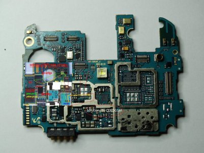

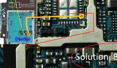

I made a new attempt to fix problem.
I took a solution from gsmhosting forum and made a connection marked bold orange line. Now all working correctly, but it is a first hoyr of testing. I will post a report in Monday.

There are all ways of simcard marked on picture. I made only one double-connection.
Now my phone works correctly. But I bought a new sim card for test only yesterday, and I think, there are too short time passed. I will post a report later.
There are 5th day of the test, no one issue, no one warning, everything is ok. I think, I finally solved a problem.
I used ground-wire of Nokia headphones, was soldering with rosin.
I recommend my method if you have good experience in soldering.
There are 11th day of the test, no one issue, no one warning, everything is ok. Problem finally solved.

kunpifagor,
Can you explain about " I made only one double-connection."?
I don't have any idea which part I need to solder in the picture.
