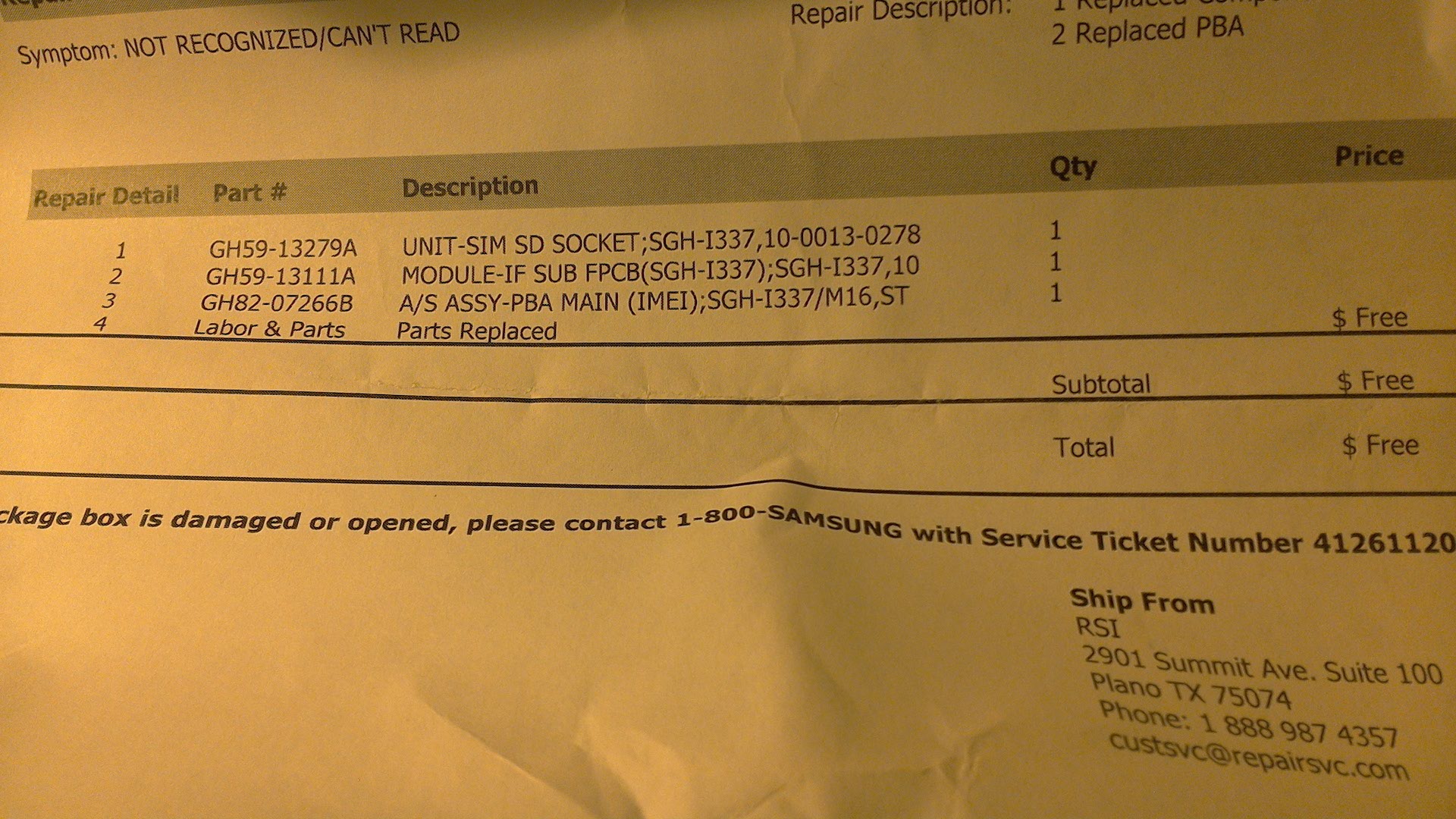

Hey all, started reading these (and this one) forums when my phone had the same problem. Did my factory reset, the whole works, no fix. I sent my phone into samsung and they replaced "component". I called and asked what this meant and they said the SIM Card reader. Good I thought, "Its fixed". Nope. Received the phone and still had the "SIM card not detected" error. Sent the phone in again. Apparently when you send it back the second time they give you expedited shipping (from what I've seen by google searching Samsung Repair Problems). For the second repair I asked to talk to a tech before he even touches the phone, and they said certainly.
I then called the day that I received an email explaining that the phone reached Plano Tx. I called again, asking to be sure that the tech calls me, and they said "yup it's in the notes". Cool, just going to wait a couple days and- bam I get an email that the phone has left the tech and is going to be sent out for shipping. WTF.
At this point I can go into more and more detail about how angry I am but I will just post the facts. They then replaced the Mother Board. Then waited a period of time to see if it works, apparently it didn't and I received a message that it didn't pass quality testing. Of course this angered me bc I assume it wasn't quality tested the first time.
I called today asking "What is the next step". The rep said that it would have to go back in for repair and I should be updated in probably 2 days. So maybe they will fix it.

I just got my S4 from repairs and this is what I got:
uhubabej
it seems to be working now.

Hi everybody just made an account here because i was experiencing the same issue! I sent the phone for repair (still have warranty). In fact, the phone was shipped to the same facility as the person that posted a picture of the parts that were replaced. So hopefully they replace the same parts on my phone and it starts to work. Once i get my phone back, ill upload a picture just like the person above did and ill let yall know if i still get the issue or not.
