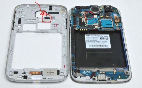

Hello,
When my Samsung S4 gave me repeated NO SIM CARD errors, I thought I would have to sell my phone for parts. BUT I was able to get it working. It has been up for three days. No problems.
1 - I did an online chat with Samsung. Not much help.
2 - I went to the Rogers dealer and they gave me a new SIM. It worked for about 12 hours. Then the error came back.
3 - Some sites suggest doing the VOL + HOME menu / Clear Cache and / or factory reset. That did nothing, other than waste time.
4 - I placed a strip of business card behind the SIM. That would work for short periods, but I think that was a fluke.
What DID work was the following:
You take apart the phone, including the white interior back plate, including the eight or so little screws.
Turns out that there is a heat related issue that makes it so that the ribbon cable connector that makes the SIM card and the microSD card tray NOT communicate with the mainboard. Maybe there is some slight warping. Anyway. Look at this image:
Literally, I trimmed a piece of a guitar pick, and glued it to the black strip on the plastic phone backing. Then, when the phone is reassembled, it puts enough pressure on the ribbon cable assembly that the phone begins working. It was a ten minute fix, and it seems to be holding up just fine. I would try that fix before replacing the SIM tray.
