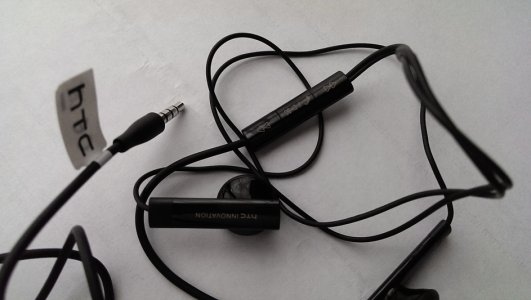

Have read through this thread a couple time. I don't think anyone resolved trying to get headphones that have VOLUME buttons working, right? I just got in these HTC headphones and the volume doesn't work either. The forward/backward button controls tracks but no way for it to control the volume that I could find. Tried some of the 3rd party apps. I usually this regularly on my run... kind of annoying. What about old HTC phones? And sounds like Samsung you can control volume.

No the old one work same way as new ones its the software side
It's not a question of the headphones. It's an issue with how the One handles the inputs right now. Likely software related, but who knows.
That's not what everyone was telling me when I first brought this up. I was told there were two standards. One that Apple created and that every earbud/phone control manufacturer uses and one that is actually the "standard" that no earbud/phone control makers uses, but that most Android handset makers (except Samsung) seem to follow.

Finally found a pair of headphones with working in-line volume controls. I just got these yesterday and they seem to be working flawlessly. They are available from the HTC website for $39.99 USD.
