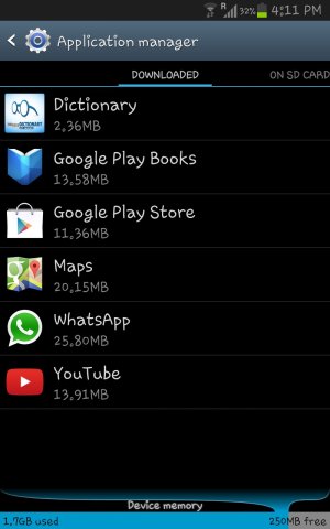

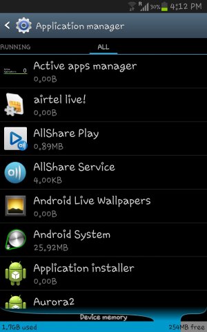

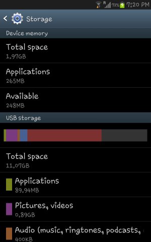

Dear GSDer,
I got the problem again, after doing the factory data reset, the phone was absolutely fine, with over a GB of free internal memory. I installed very few apps such as Skype, Twitter, Hotmail, Wats app, BBC, Economist, Play books(had only one book of 2mb) and FT. just that. I never visited Google play for long time, but to my surprise, the internal memory was nearly full, left with just 182MB free space with a warning message, so I deleted almost all essential apps, Now I have only wats app, map, dictionary and 2 others, all put together make no more than 90 MB, but still the free space available now is just 250 MB.
Apart from that, I got contacts stored for about 7 MB and close to 20 text messages in total. Moved all possible files to External storage.
I have tried doing clear cach by holding power, home and volume up buttons, but nothing helps,
Please help me to protect my phone going into another factory data reset and firmware upgrade. I don't really know what is eating my internal space as all my photos, videos are stored in external storage which also has over 3 GB free space. I understand that as and when I use the some apps like Twitter, the catch can grow, but frequently I do "clear catch" and now I have uninstalled that too.
Something is rotten in Denmark! (the poor Danes always get blamed for this one )
According to the specs for this phone (ex. http://m.samsung.com/latin_en/consumer/mobile-phones/galaxy-note/galaxy-note/GT-N7000ZILTTT-spec) it came in 16GB and 32GB variations; if we assume that stock Android occupies ~5GB then you should have ~11GB shown as the Total space in Device memory (assuming that you have the 16GB version), which is nowhere close to what you have. (BTW, do you have an SD card installed? If so, remove it until we get to the bottom of this.)
I'd suggest using the Kies software to completely reload the firmware on the phone to see if it corrects this problem.
Or you can use Odin to reload the firmware, which can be found here - mouse-over the region codes until you find your country/carrier.
In either case, once the firmware flash is complete be sure to boot into Recovery mode and clear the system cache. Then skip all of the activation/setup steps and check the Storage view to be sure that the correct amount of space is shown.

Yes mine is 16 GB version and I no SD card is installed.
I will do as per your guidance. Thanks a ton again!..
Hi GSDer,
I would like to share what happened.
Just before reloading Firmware, I dialed "*#9900#" then selected "delete dumpstate/logcat" which was my friend's idea, And much to my surprise 1.5 GB of space was cleared.
Thank you for the your continuous support.
