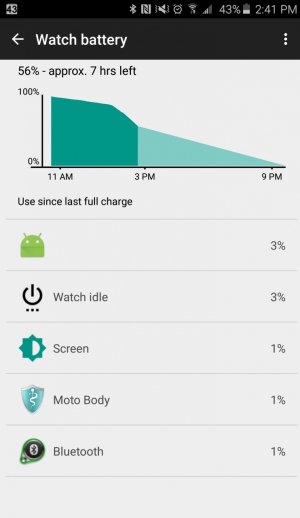

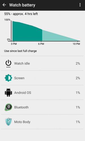

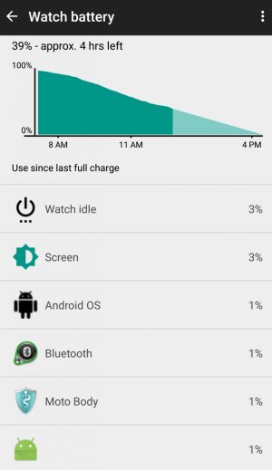

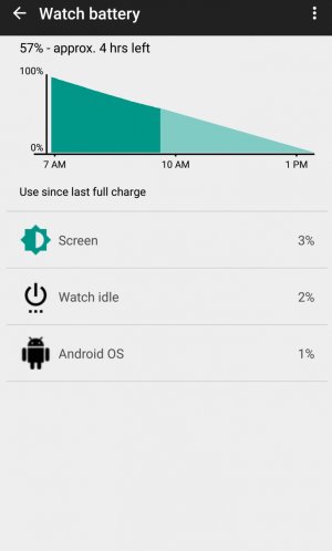

Well I guess I'm just unlucky then. Here are some screenshots from today and yesterday.

Yep. Your drain is 4.28%/hr.
I have it all on except tilt-to-wake and heart rate stuff and I am at only 2.78%/hr (which equals 36hrs projected)! Granted, I have had zero notifications today and have interacted with it only a few times.
Yes, and that was my first full day having the 360, so I was definitely messing with it more than normal. And I still got to bed at 1am (so, approximately 17 hours off the charger) with about 40% battery left. And, again, that was with EVERYTHING turned on - well, except I have Brightness set to Auto. I suppose it would have burned more battery if I just set it to Brightness 5.....
@me23brown having 8-10% / hour drain has got to be something with his/her (? I don't know) phone or some app on the watch.
