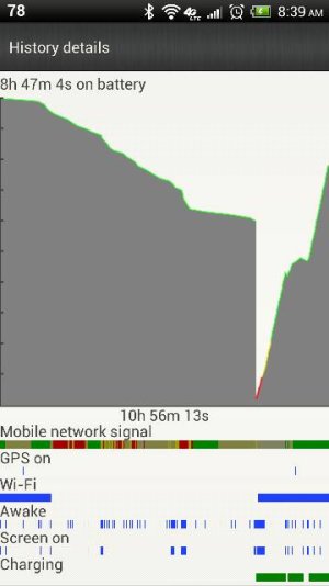

Instant battery drain (to 0%) on AT&T One X

I've had this on a much less dramatic scale. From like 14% down to 3% in an instant. Annoying. It happened also after I rooted and ROMmed, so it wasn't an HTC software issue.

Got this phone in November on Black Friday. In that time, I've returned for replacement twice. All three phones have the instant drain battery issue. First two I stayed stock...Actually the first one, I didn't install any 3rd party apps. It just started the first day with dripping from about 80% to 0%. Kept it about a week before returning. Second phone, I installed some LWP and a few games like Angry Birds and Shine Runner. Same battery issue. Now, I'm on phone three and I've unlocked and installed UrDroid 1.8 ROM. I had gone for close to a month without a battery crash (still happens randomly), but it happened again just now. I took the phone off the charger approx. 3 hours ago and drained to 0% in that time. No LWP running, but I did play the game Diversion for about half an hour. Battery died when I went to homescreen. I keep WiFi on when I'm at home, but I never use the mobile LTE connection even on the road.

Team Venom ViperXL 3.2.8 seems to have completely solved the issue for me. Apparently the drain has to do with the voltage settings in the ROMs, and the default on Team Venom's ROM has solved my problem. No reboots OR instant drains in about six weeks (since I installed it).
