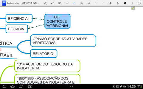

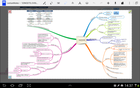

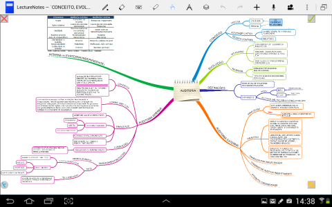

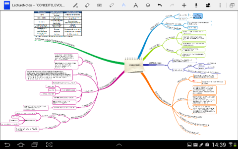

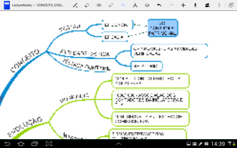

Hi! I have problems with import pdf for Lectures Note. I am losing quality after I push the check boton (the green one).
So, what can I do?
I will put some pictures to help comprehension.
I changed my import pdf setting, but it didn?t help.
I am from Brazil and sorry about my english.
thanks!
I create a 2 page Lecture Notes file and then put it in the over view mode. I then open the pdf file with a pdf viewer (DTG) and then SEND it to Lecture Notes.
Via my Note 3
@TMARFER: LectureNotes is bitmap-based, and the resolution after insertion is the resolution of the notebook into which you insert.
OK! So, how can I change the resolution of the notebook? Is it in the create page? if yes, how can I do this?
@TMARFER: You cannot change the resolution of an existing notebook.
When you create a new notebook, adjust width and height.
