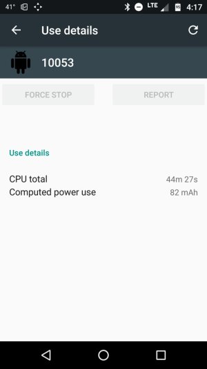

Re: What is 10053 in battery useage
Have you recently uninstalled any app? Usually these 10xxx processes refer to apps that were removed after your last full charge. It should disappear on your next battery cycle.
