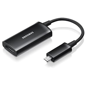

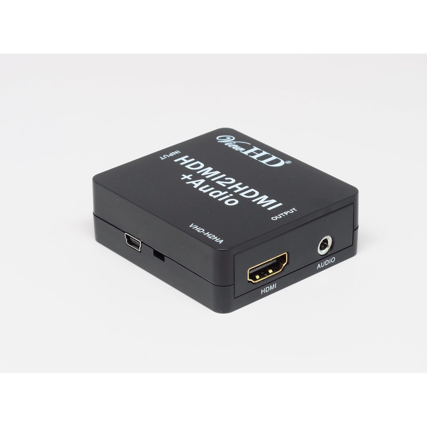

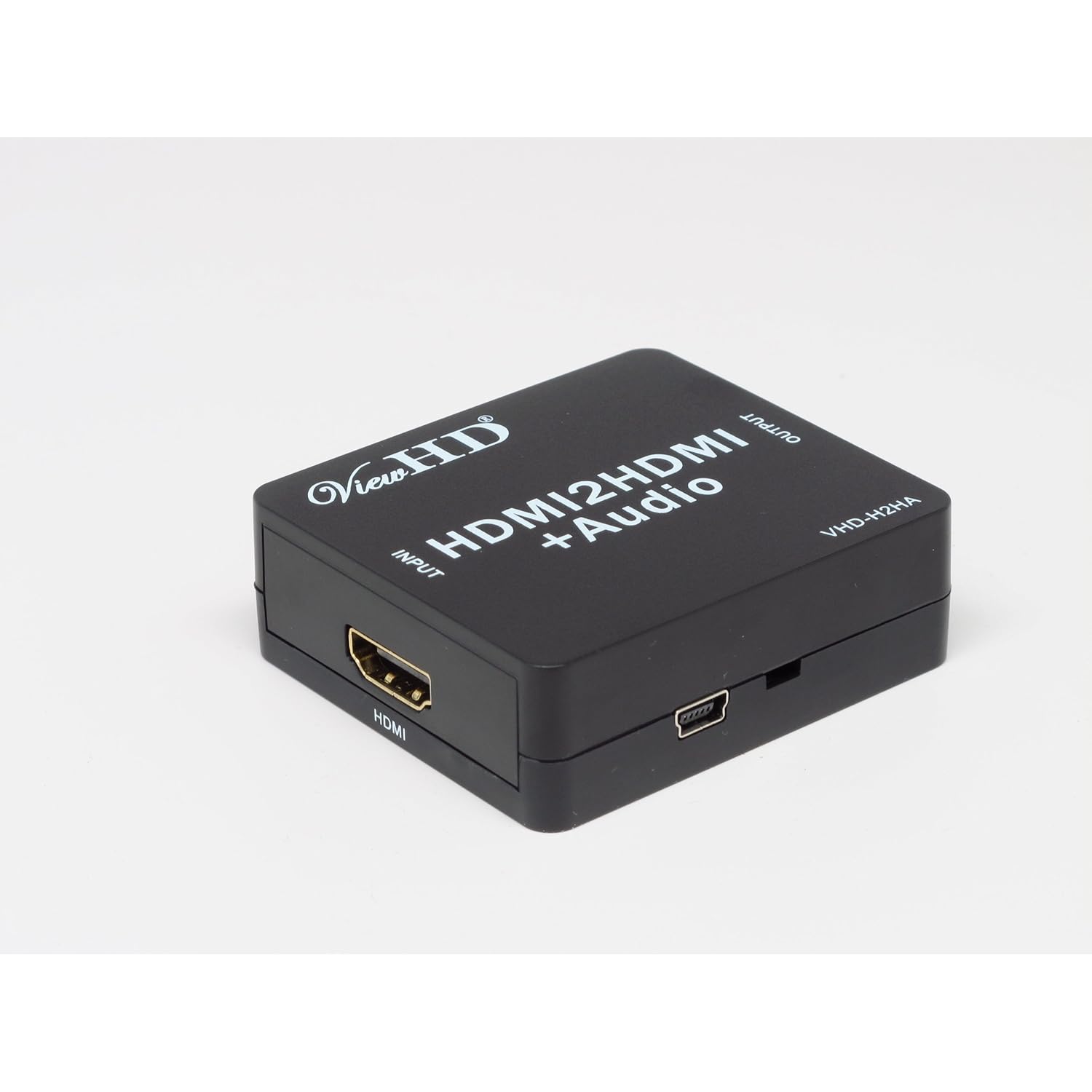

Galaxy s3 > mhl to hdmi > hdmi input to hdmi/3.5 stereo outputs
Hdmi output goes to my hd monitor
3.5 audio goes to my computer speakers (aux input)
Will this work?
Sorry for the screwy image sizes. Make sense now?
Thanks for any help.

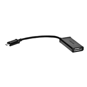

You're going to need a (11-pin) MICRO USB to HDMI cable for your input as well. Looks like the 'MINI USB' port is for powering the device. The Samsung MHL will be less hassle than this option.

Thanks for the replies. The pictures I posted may be misleading... the cable I have is the one meant for the Galaxy s3 as shown below
So, given that I have this cable, do you think it will work? The pin issue confuses me, will this cable make the difference or is another one necessary?
Thanks.

Assuming that box actually works, I don't see why it wouldn't work with the MHL adapter - it outputs a standard HDMI signal.
Doesn't your monitor have an audio output already? Or are you just not satisfied with the sound coming from the built-in speakers? You could always connect the HDMI output to a stereo receiver and drive some really good speakers that way.

Yes I generally run it to a large stereo system. My sub and satellite speakers are a temporary substitute. Thanks for the help. I'll purchase and follow up.
