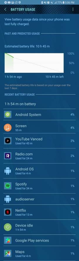

Here is my usage. Tell me if I should expect better? I usually unplug about 0900. A d here at 1254pm CDT, I'm at 26%
