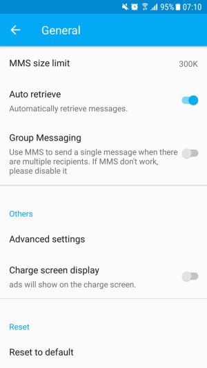

Just disable the Charging screen switch and you will never see this again.
