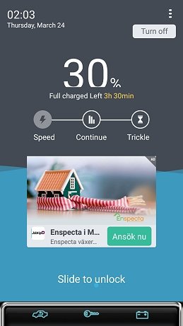

New Speed Charge/Battery Status Lock Screen with annoying ads "just appeared" on GN4
This was happening on my Galaxy Note 5.

OK, I finally figured out why it's behaving this way: there is a new setting under Advanced, called 'Quick Charging'. I don't know what, if anything, this actually does, beyond setting up that ***obnxious*** fake lock screen.
I do have a screenshot, but I can't figure out how to attach it via the mobile page.
