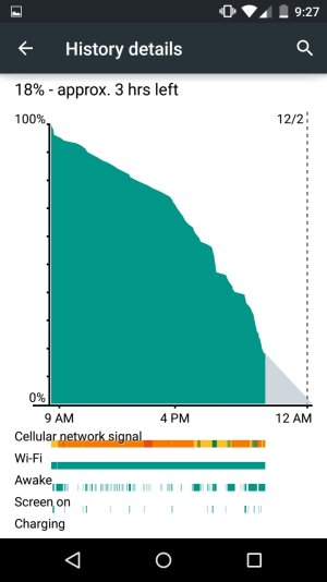

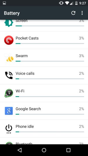

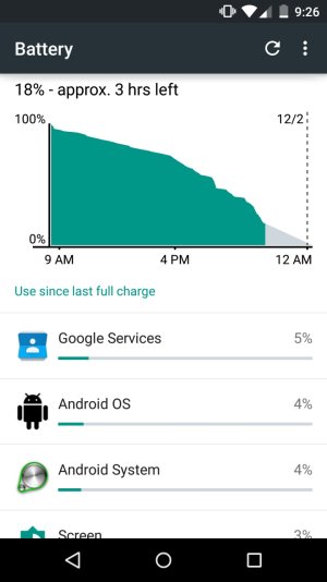

Add me to the chorus of people who have seen decreased battery performance since the Lollipop upgrade. With KitKat, I would usually be around 30-40% at the end of the day, but now with the same usage pattern the battery saver mode usually kicks in, so I end up around 10-15%
Here's my usage for today. The first half of the day was fine, then things took a dramatic nosedive. I used it pretty lightly today, with only 30 minutes of on-screen time, 15 minutes of phone calls, and playing some podcasts in the car via Bluetooth. Despite that, my phone was just hemorrhaging battery, losing what felt like 1% a minute at times.
I've disabled Google Fit per the advice in this thread, and I tried disabling smart lock to see if that made any difference, but I don't think it did. I have no idea what's going on, but at this point I would roll back if I could.

My battery since Lollipop seemed to be ok, maybe just a little better than Kitkat but over the past few days it has taken a dramatic plunge for the worse.
For example today, after just 3 hours I have 77% left and the highest users have been gmail, google services and Android OS (all 4%) and then screen (2%).
Something must have changed to make these so high, it's not like I've even read any email this morning...

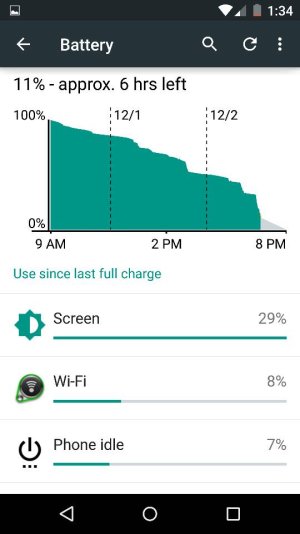

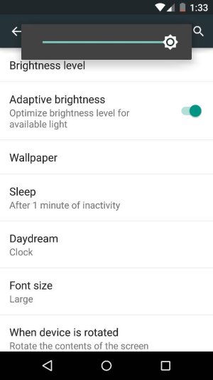

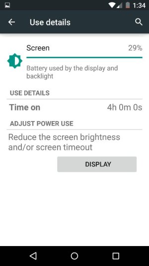

My brightness is cranked all the way up.. What can I say I like it like that.
4 hours of screen on time with 11% remaining.. I'm happy with that considering my brightness level.
