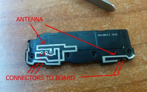

I disassembled my nexus 5, and during the process, i checked my reception signal. once i removed the bottom part that has the speaker in it, i checked the reception signal, it didn't change at all. this part has the antennas in it, the silver snake thing, that is supposed to boost the signal once connected through the 3 connectors on the other side (or 2 connectors depending on which reception antenna, signal 3g and wifi), linked to the board. but unfortunately, this antenna isn't working. the phone is taking its signal from the board only, the booster that must make things much better isn't working at all for some reason.
attached is a photo that explains the parts i'm talking about.
You may have faulty hardware. Lots of variables to consider with cell signal. The only Nexus I've had with poor signal was the GNex, and it was Sammy's **** poor QC to blame. A large # of RMAs confirmed it wasn't just a few devices. Otherwise, I just compared my N5 (on latest 4.4.4 radio) on Tmobile to 5 other devices in my office (4s, 5s, M8, Z10, S5) that are also on Tmobile and my N5 has as good of a signal as any of them in this concrete bunker. Switches from LTE to 3g/edge very quickly too (goes from LTE to HSPA/+ everytime I get/make a call so I notice). May want to RMA your device. Stinks, but Google makes it pretty painless.
