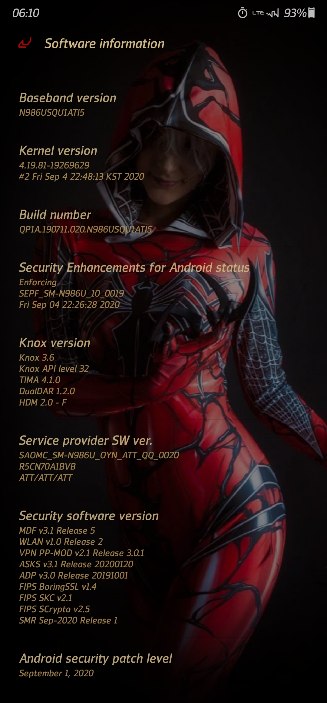

AT&T Note20 Ultra 5G 512GB, September Patch.
