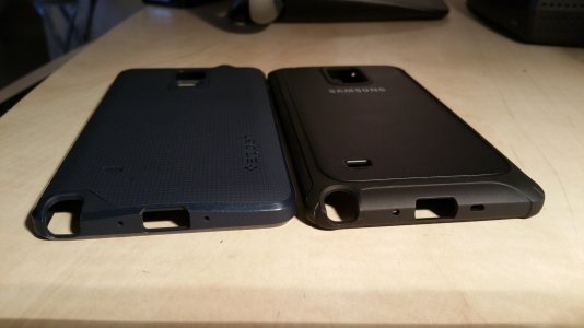

So I did a little investigating with my reading glasses and a bright light and there are three microphones on the Note 4...two that are mostly for your spoken phone audio are at the very bottom of the device....little needle holes. When I look at the rubber case liner and the outer exo skeleton, it doesn't look like the holes line up so the mics are covered. The mics are way low on the bottom of the N4, but the case holes are kind of centered top to bottom...not going to allow audio in! :'(
Somebody in the lengthy "what case are you going for" thread posted that they had received this from Supcase after ordering.
I was like you in a way and ordered a Spigen case (the Capsule TPU) to cover the time before the case I really wanted, the Samsung protective cover, arrived. I note the holes in my Spigen case do line up with the mic holes -- I'm on AT&T, so I would guess you're not. I should also note that on the Samsung case itself, one of the two holes is elongated to accommodate the different mic locations.
Case manufacturers either have to do what Samsung did and elongate one of the two holes or sell separate versions by carrier. If they don't do either, and one of the holes is covered up, it's defective and should go back.
Spigen rushed their cases out to take advantage of early adopters and early pre-orderers looking for a case.

Here's the Spigen Capsule side by side with the Samsung protective cover -- you can see the elongated microphone hole on the Samsung cover:

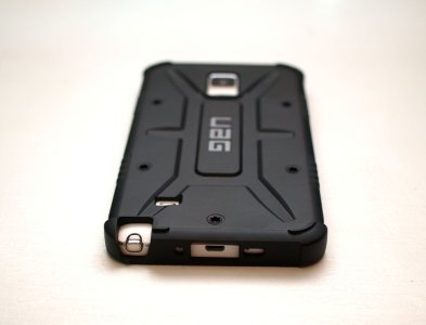

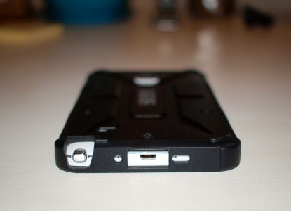

I ended up with a Uag case that has access to the mic ports. Sorry for bad quality, took this with an ancient 10 megapixel dslr.
