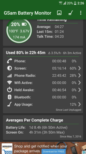

I crack myself up. Turned on BT...but work had me hoppin today so virtually no use of my phone. OPC is just plain stupid sometimes.
Even without much use that is still pretty damn good. I cannot get close to that at all. I have used 29% in 15 hours 30 mins (which is still pretty damn good) and that is with very light use also, only 30 mins SOT. How you are getting a full day on 20% I don't know, but that is fantastic :)
Your last published screen shot shows a lot of "Held Awake" time. Thats time whether or not hte screen is on that the CPU is crunching on something. Large periods of Held Awake means maybe a background process has gone rogue or something of that nature. Depending on what you have installed will lead you more to whats keeping your CPU doing something.
Youll notice that the S7e screen shot above and mine have very little Held Awake time.
Good point. How does one go about trying to determine what is keeping the Held Awake to be high?
You can see if GSam root unlock functionality works (I have not tried but it didnt work on my DNA). Its, unfortunately, a process of elimination. I dont tweet, facebook or anything like that. I have Gmail, and two other email accounts. The Gmail is push notificaiton...the others being of low importance are once an hour checks.
