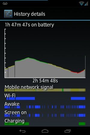

Reboots are annoying........ Only thing that I hate about ICS. CD
@TheKraven, is there a flash able zip for Headphone fix?
Sent from my LG-VM670 using Tapatalk 2

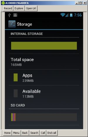

Hello,
On the Data2EXT question;
I went ahead and checked my internal storage information. It had said that I had 143MB available. I went ahead and began installing several apps. Now, it says that my available internal storage is around 84MB. That said, I don't think that the Data2EXT Mod is working correctly.
There has to be a way to verify this. Does anyone know of a few lines of ADB code that I can use to verify this?
Any other ideas?
Thanks!
BJ
Re: [ROM]COLD AS ICE-CM9 Sprint LS670 10/13 ZVD basesband Alpha18
Go to terminal emulator and type the command 'df' to check the usage of the sd-ext -assuming that you had wiped it before flashing the rom.
Sent from my LG-LS670 using Tapatalk 2
Ok, so I went ahead and typed 'df' in ADB Shell. It confirmed what I thought about the SD Card:
Now, when I look at the 'Internal Storage Info'...it changed. Now it says I have a few more MBs available, but not the full capacity of the EXT partition:
There has to be a way so that the Internal Storage info reflects the correct capacities of the EXT partition.
Any suggestions?
BJ
I don't think so. On the other hand, since you have 3GB partition, you shouldn't worry about it too much.
