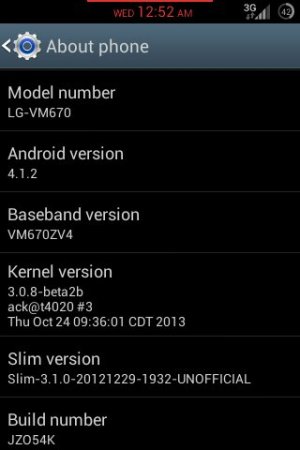

Re: [ROM][MOD][THEME] Bean_Whiz-CM10 Updated 12/03/2013
I also can comfirm beta3 working, with a few extra tweaks as mentioned above. Although, in about phone, beta3 still reads as beta2b.
So far, major implements in speed compared to before.

ah. the 'integration' didn't work as I recall, so I pulled it. it says 2b in phone info because I never updated it.
