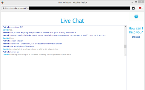

Per a chat with a Samsung tech that I just had... They say it is software and will have a fix.
and do you believe fix will arrive ? After how long they need to make fix? its been from middle of April more than a month passed....ppl already forgot samsung and bought new phones, i think samsung is gona lose lot of loyal customers.....
It's not a software issue. It's a hardware issue that can be fixed with software patch. Your accelerometer is burned out if it's stuck on one access. I sent mine back to samsung and they replaced the part. I can no longer find the test menu for that part after Sprint pushed the new software update that changes the screen rotation from the accelerometer to the gyroscope.
