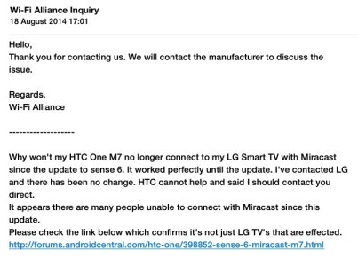

Whoop! I emailed WiFi alliance a few weeks ago and they finally replied today. Fingers crossed things will start moving in the right direction now.
