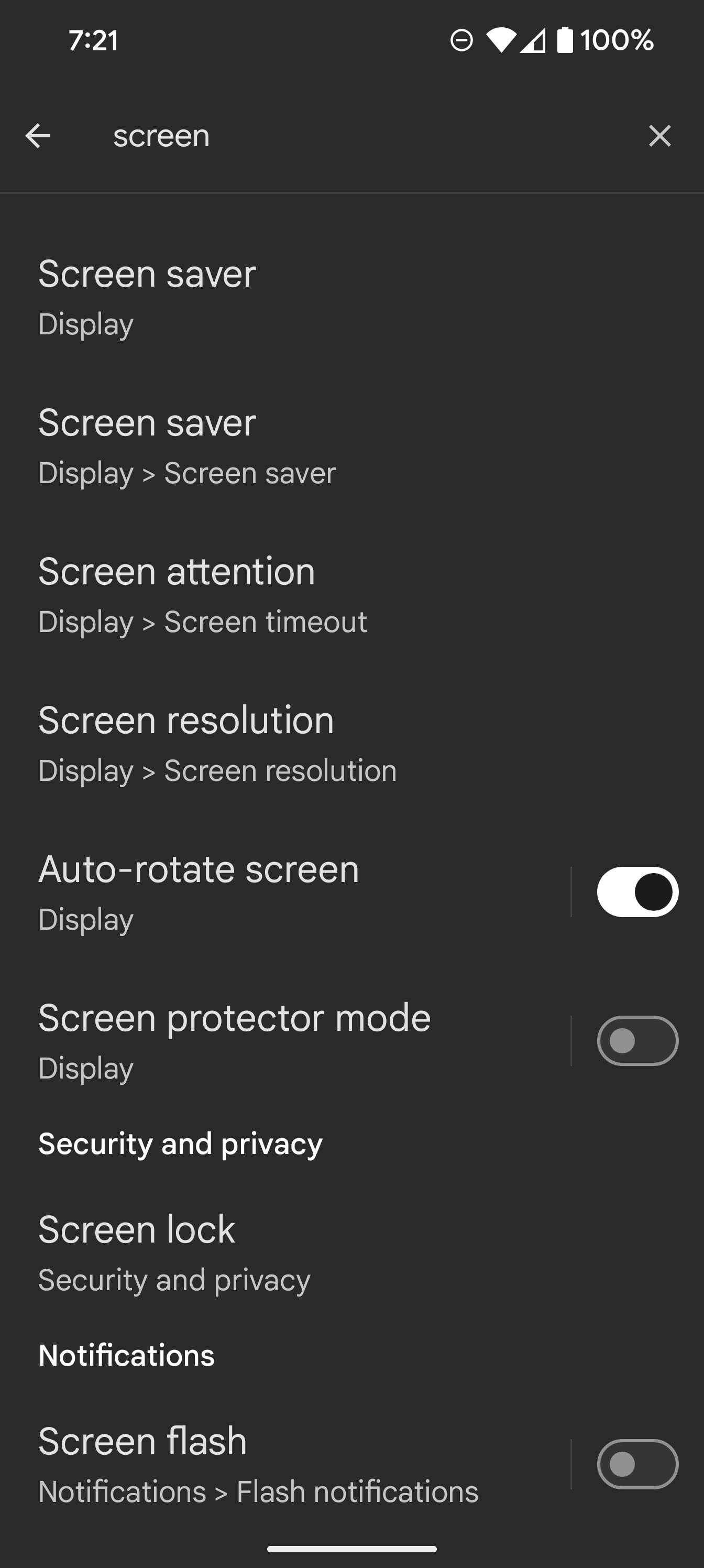

Screen protector was on, now it is off. No change in the behavior. I was able to add one fingerprint but not a second.
