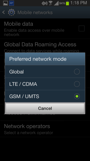

STEP 2 Get your Samsung Galaxy S3 SCH-i535 (Verizon Only) go to settings , more settings, mobile networks, network mode (switch to GSM/UMTS)
STEP 3 Turn off phone, remove verizon micro sim, insert att sim from Straight talk, turn phone back on wait a few moments and try to make a call to a friend so you can get your new phone #. You will recieve a txt later with your number from Straight talk. If it doesn't work immediately please be patient and double check you are in GSM mode.

IN MOBILE NETWORKS this is what you should see if you have the VERIZON SCH-I535 RUNNING 4.1.2 ONLY!!!!!!!!!!!
This has not been confirmed with any other phones!
