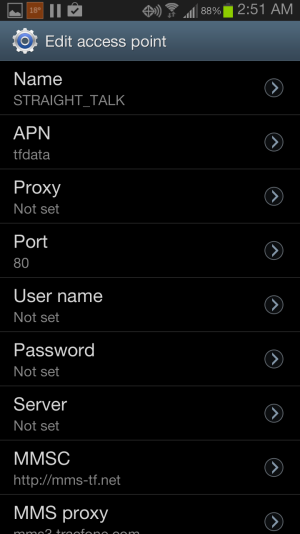

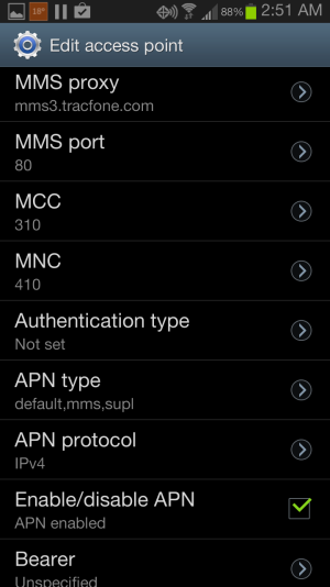

If it is a Galaxy S3 with the model number SCH-i535 and it is running Jelly Bean 4.1.2 or higher, it requires no hacking or unlocking at all. All you need to do is get the right SIM card. In my case it was AT&T. If AT&T works in your area, just get that SIM card out of the package, go to stbyop.com and activate a monthly plan on that SIM card. Next, pop it into your phone and turn it on. After it is in your phone, go to settings, more settings, mobile networks, network mode, then select GSM/UMTS. You should now be able to use the phone.
The next thing would be to set the APN settings which is just as easy to do.
Go back one menu to mobile networks, then click on access point names. You should see LTE Verizon Internet. Hit the menu key to the right of your home button at the bottom of your screen this should allow you to add a new access point.
Put these settings in:
APN: tfdata
Port: 80
MMSC: http://mms-tf.net
MMS proxy: mms3.tracfone.com
MMS port: 80
Restart the phone and turn your data on and you should be all set!
There is nothing that I cannot do on my phone now. The only thing is that the 3G is a little slow, but I mainly use Wi-Fi anyway.
