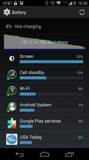

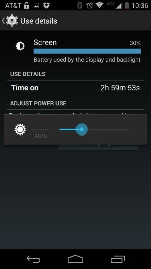

What's going on with the battery life here?
Just over 2.5 hrs of SOT before it died, and only 10 hrs off the battery. Not sure what else to do here but hope for improvement with lollipop.

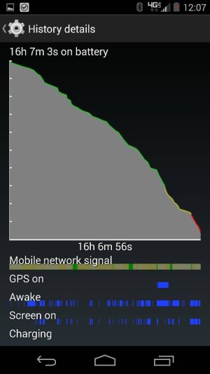

There's too many wake ups, your battery life should be double what you are getting, i'm playing with my X all the time it;s only been charged Twice properly it goes into single figures after 24 hours with 4/5 sot.
That 'awake' line should be black when the phone is off.
You need to play hunt the app I;m afraid!
Actually looking at it, it seems the screen is turning on so often that the phone can't sleep, so you have adaptive screen on? Use it it doesn't wake the OS

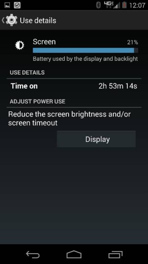

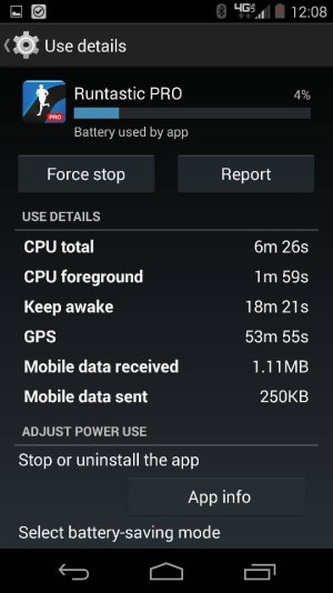

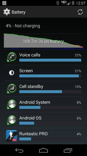

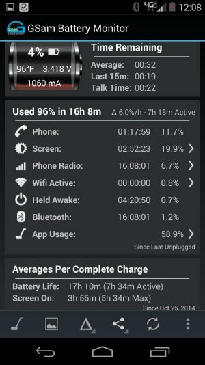

So here are some shots taken just moments ago, no WiFi this time.
I work from home and am usually on WiFi most of the day. So I decided to turn WiFi off and go LTE all day. I was at home as well as away from home today, as you can see in the antenna signal bar.
* 16 hrs (4% remaining) - All LTE
* near 3 hrs SOT (mainly lowest bri)
* Poor to ok reception
* 1.25 hrs voice calls
* 16 hrs Bluetooth on (paired to 360)
* ~1 hr GPS on high accuracy
* 1.25 hr online music (screen mainly off)
* WhatsApp, hangouts
* 5 gmails 1 yahoo syncing
* not rooted, but still using Greenify to hibernate some wacky apps
* (Verizon)
