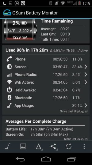

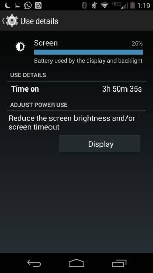

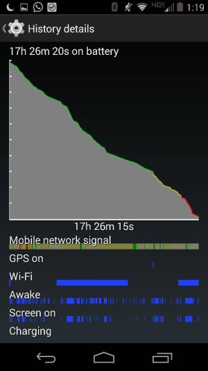

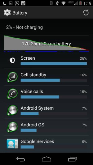

What's going on with the battery life here?
And to put the cherry on the top...
* Battery currently at 2%
* 17+ hrs on
* 17+ hrs Bluetooth (Moto 360,seen in last screenshot)
* ~4 hr SOT
* 8+ hrs is wifi (so half wifi half LTE)
* cell signal between bad to ok
* sync on for all 6 email accounts
* whatsapp, hangouts
* Google Now on
* screen brightness some auto, most lowest setting
* avg drain 5.6%/hr
* don't have FB installed, but G+ is sync'd

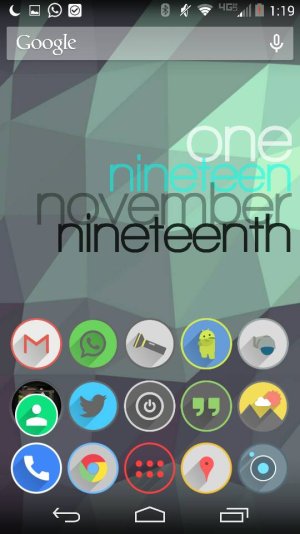

Screenshots, taken just moments ago, starting with my awesome looking home screen. Consistent time throughout (1:19am 11/19 coincidence):

Very impressive, the SOT is amazing, and all those things enabled! I just did some testing overnight, phone drained 8% over 8 hrs. Not too bad. Going to see how it plays out at work.
I noticed a big difference when I switched from "global" radios to the lte/CDMA setting. Could just be the area I'm in but I've heard other people have had good results switching the radio selection

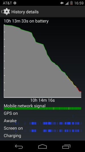

That's 1.15 of SOT btw. This battery life just plain sucks. My 3 year old HTC One X does better and the battery is 3 years old.

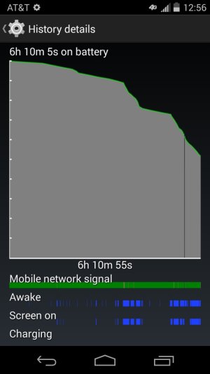

@neocryte Re that vertical line through the right side of your battery screen cap - if you can recall, did the timing of that coincide with a system crash?
The Moto X I returned would crash every day or two -- screen would go dark and I had to hard re-boot -- and I had the same vertical lines in my battery report, plus the report would show a sharp drop in remaining post-crash power. Based on that battery report and power drop I concluded that this might be an electrical/hardware issue and returned the phone while still in my 14-day window.
I actually rebooted my phone there, because Google Play was acting up. But nope no crashes on my end, seems to be running stable.
Good to hear. Your report didn't show a steep power drop like my experience. My phone was smooth and fast other than the crashes, and after flirting with buying the Turbo I'm probably going to re-order an X. Just don't want to see this problem cropping up elsewhere.

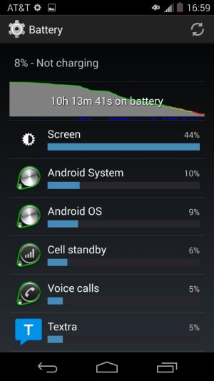

Just over 2.5 hrs of SOT before it died, and only 10 hrs off the battery. Not sure what else to do here but hope for improvement with lollipop.
What do you have your brightness set to? If it's automatic, are you using it in an environment where it needs to pump the brightness up?
