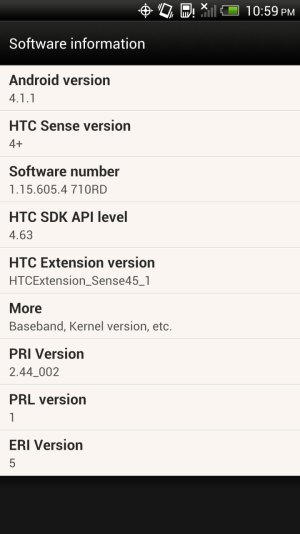

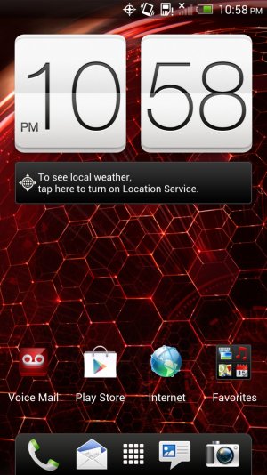

I added two screenshots.

It looks like you're running the stock version. If you can connect to 4G somehow, by inserting a SIM card you could get the latest software update. This should hopefully break root, and bring you up to date with the latest stock firmware. If you would prefer to keep root, I would try doing a factory reset, or flashing another ROM.
Usually when you see the wifi stuck on "turning on" followed by an error it's because you try flashing a rom while so-on without fastboot flashing the boot.img.. It's weird that you're seeing it on the stock rom..
Can you try turning the phone off and then hold power + volume down to get to the hboot and see if you see anything mentioning about being s-on or s-off? Then use the volume keys to select recovery and push the power to see if you have a custom recovery installed or not.

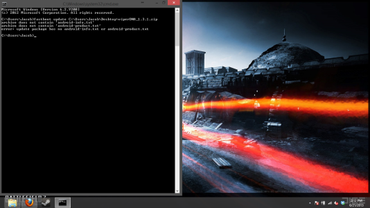

I'm using that link and I typed fastboot -w into command prompt and it just endlessly says "< waiting on device >". How long does it usually take to wipe the device?
Ignore my last post please. I got everything figured out and wiped the device using fastboot but, when I tried to update the rom, i got this error.....
To flash ViperDNA ROM using TWRP recovery you want to follow the instructions in this link:
[ROM](6.13.13) Team Venom ViperDNA 1.3.3 l | Droid DNA > XDA
Simply put, you download the file to your SD card, boot into recovery, do a backup, format and reset, and install the .zip file.
If you have any trouble following the instructions there or have any questions I'll be glad to help. Sorry it took so long to reply, I've been a little busy.
