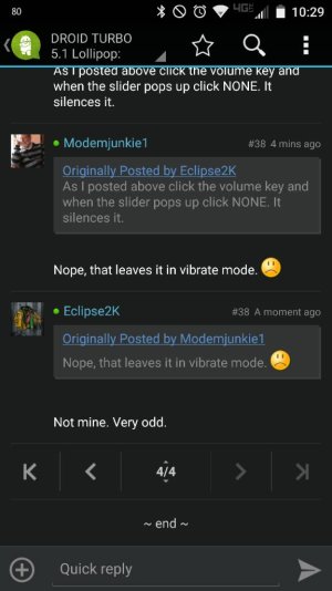

I need a fast way to turn off all sounds and vibrations. I was at a play yesterday and the Facebook pop and vibrations drove my neighbors crazy. .And of course I didn't dare turn off the phone because I feared the droid growl would broadcast.
I like the volume up/down rocker way of getting to the controls but it should have a no vibration option as well. Any other solutions?
Re: DROID TURBO 5.1 Lollipop: Sound Profiles, Volume/Vibrate/Silent Controlsiclikecthe
As I posted above click the volume key and when the slider pops up click NONE. It silences it.
Do you put your phone in vibrate first? I just hit Volume Up than select NONE. I don't change my volume from full but rather switch it with that button. I get the no sound icon.
VIP and non don't get through with even a vibrate.
