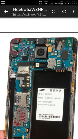

Vibration motor is right blow gps contact point , that could be causing issue from get go.
That would also explain those doing clear catch , install new roms etc reboot finding their gps works again.....for a little while at least until next vibration alerts
GPS contact point circled in red , Vibration hardware black circle right below

A couple days of Note 4 in front jeans pocket putting stress on frame made the magic happen.
With GPS Test app enabled I Took back cover off , applied minor pressure on antenna area & bingo lock achieved 15 of 18 in use
Releasing pressure provided 0 of 18 lock lost.
Shame on Samsung for such pathetic assembly!!
The temp temp fix was backing out a couple screws in antenna area then giving them good tighten.
I will do take apart in coming days making true fix.
