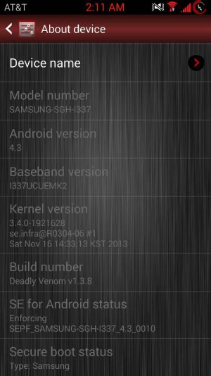

In order to help you I need you to do this go to settings> more> about phone and I need the model number and the android versionv the build number
