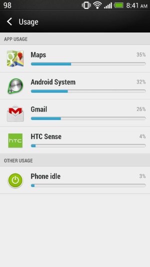

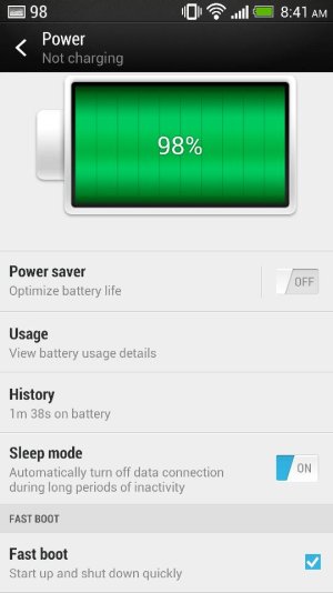

I have got the phone one week back and have done couple of recycle charge with battery.. Last night I allowed it to die before plugging in the power and left it off... I have switched on the mobile come of minutes back and this is the start..... Lets see how I go during the day with routine use..plus some music on the train while going to office and no gaming uploadfromtaptalk1367480944104.jpguploadfromtaptalk1367480944104.jpguploadfromtaptalk1367480959336.jpg
