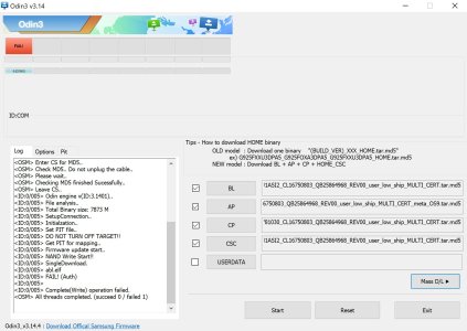

I guess I'm struggling here. I have an unlocked Note10+ and trying to flash the ATT firmware (only one I can see from Ruben is from October 2019) and not having much luck. I've completed all the steps and via Odin I receive...
You using prince comsey odin ?
What Firmware build You On Cause if your trying to odin Oct Firmware that has bootloader v1 i'm assuming your on bootloader v2 so you cant go backwards on bootloaders.
Yeah true , most likely on latest unlocked version why can go to that Oct firmware. You have the recent Att firmware?
Thanks Ruben. Unfortunately, there are no download mirrors with this AFH...at least not that appear for me. Thoughts?

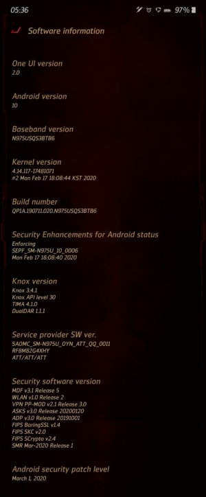

AT&T Note10 Plus Firmware Build N975USQS3BTB6 March Security patch, bootloader does upgrade from v2 to v3.
