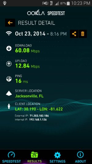

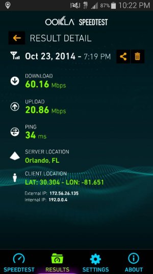

Hm not sure what could cause it. Below is an LTE test and a wifi test I did.. Both are what they should be. The wifi I use at home is 5 GHz set to the AC standard.
Is it like this on all wifi networks for you? Or just the one?

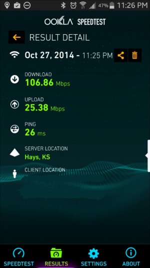

Here's my speed test

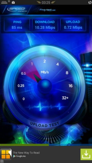

Sorry for the late reply.. The router is the one comcast supplied me with... I have rebooted phone and everything... I turned off optimized connection and it has 10 mbps download... The first few seconds of the test it goes up to 25-30 mbps and then goes down to 10.... My wife iPhone 5s stays up high the whole test.
