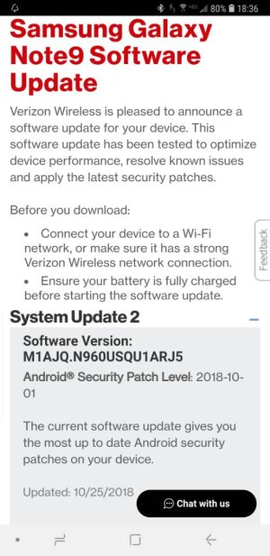

Verizon "System Update 2" hit my phone last night. It is the security patch for October. It also seems to be more than that just the security patch.
My camera was freezing up continuously, it was frozen more than not when I opened the camera. I switched to the Camera FV-5 app for a workaround until Samsung could come out with a fix.
I have opened the camera several times since the update and have not experienced any issues. I'm definitely not confident that the issue has been resolved but I am hopeful. Of course the update process reboots the device and the camera could be responding correctly due to the reboot. I don't think I'll fell comfortable until I've not had an issue for a week or so.

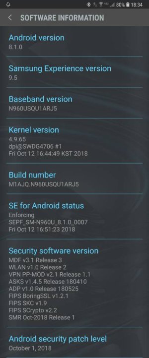

Which firmware version is it, and what do the release notes say it includes?
1ARJ5 and the notes don't say much.
I like the part about "resolve known issues". Keeping my fingers crossed.
I had the opportunity to take about 40 photos today over the course of an hour and did not have any issues. So I remain hopeful. It will take at least a week before I start to feel comfortable. Screenshot_20181026-183650_System%20updates.jpegScreenshot_20181026-183421_Settings.jpeg
