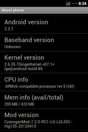

EDIT:has anyone checked out the live logcat and dmesg apps on the play store? Just curious if these are able to be outputted to a .txt file on the sdcard so I can install them and push in some of the .so's and reboot and see what's causing the bootloop when they're present, anyways I was going to use adb but I can't get it to work when I have cm installed as soon as I restore to mobster ROM adb works just fine I've tried installing drivers for the optimus Q with no luck but it's really odd when adb works the LG support tool doesn't but when adb doesn't work (I.e. when I'm on cm7) then the support tools says I have the VM701 connected via USB...
Sent from my Nexus 7 with CM-10 using Android Central Forums
A screenshot from cm7 running gingerkernel

Nowhere back to needing vendor blobs which we'll probly never get at this point it's pretty much dead :/ I'm sorry to say
