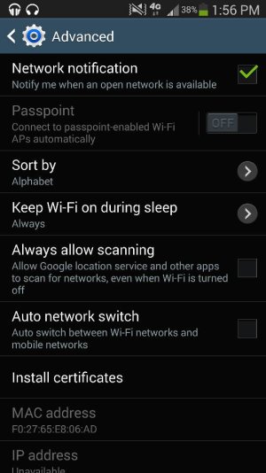

Most have found it to be an issue with the "auto network switch"option under wifi. Ensure it's off and you're good.
Sent from my T-Mobile Note 3 using AC Forums.
Yeah, I've been following that. The latest I saw was that it temporarily helped; their issues returned after some time, even with that auto network switch disabled.
the auto network switch won't do it by itself.
in the phone dialer hit , " *#0011# " then turn off wifi power saving.
