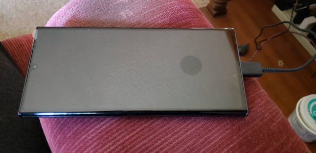

My Whitestone Dome kit for my Note 20 Ultra will be here today. I looked on their website and didn't see anything mentioned about Blue Light Filter on the screen protector I ordered. I guess we'll see. If it has this, I will be returning it and seeing if I can get a clear one. I don't like the blue light filter and never use it, so having it without a choice is not a good thing.
