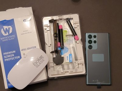

Well, the one disappointment of an otherwise awesome new phone experience is that I could not install my Whitestone Dome despite three meticulous attempts and prior experience installing UV cured screen protectors. I simply couldn't get the glue to spread across the entire screen. I gave up on this and will simply have an overpriced tempered glass protector installed by a professional at a cell phone store.
When u center the glue and then removed the top piece to drop the screen protector it didn't start spreading? If it didn't go in those areas just tilt the phone in those directions to allow flow
Thanks for the suggestion. I did indeed try this and it helped somewhat. But there were still some gaps at the bottom where I couldn't get it to spread. I'm sure it's user error on my part, which is unfortunate since it looks like it would have been a great screen protector. But I don't think I could do it correctly even if I had ten screen protectors. My deepest respect to those of you who have the skill to pull this off.

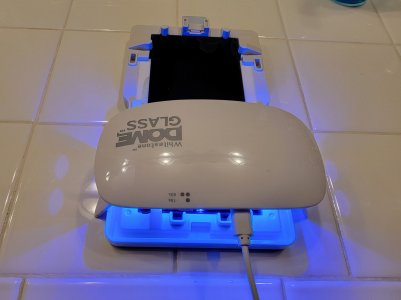

Put my Whitestone Dome screen protector on yesterday and the back camera protector on as well. Feel like the improvements they have made to the jig help make the process more efficient. I've started to cure mine the following way:
1. Initial 15 seconds in the top, middle and bottom.
2. After taking it out of the jig and taking the black tape off around the edges (I don't really wipe the glue on the sides unless I see a glob), I cure it 60 seconds in the top, middle and bottom.
3. Then one more go around with curing it 60 seconds in the top, middle and bottom.

Both installations totally screwed up. The adhesive just wouldn't spread all the way on either. It says to give it 100 seconds. I waited seven minutes. It's like they haven't put enough adhesive in.
Had to order more and race to best buy to get an overpriced rubbish Zagg one fitted to see me through until they're delivered.
