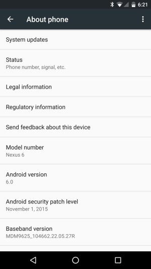

Out of morbid curiosity I removed my VZW sim and did a factory reset. During the reboot process I skipped all the Google account garbage and boom. Got the notification 6.0 was available to download. Nabbed it, reinstalled the sim, rebooted again, cleared the cache and it's done.
Phone seems much faster. Haven't seen any major bugs so far. Did notice it grabbed build MRA58K and not MRA58N which contains the November security patch.

I have a Unlocked Nexus 6 on Verizon and I finally received the Marshmallow OTA download notification this morning at 11:30AM PST.
I completed downloading and installed it this afternoon and noticed it was build number MRA58R which has the November 1st Security Patch.
All seems to be working well so far.

I pull sim and did a factory reset got the update . everything seems fine boot up didn't change though. Still have the twirling dots.

Sounds like you got the Nov security patch instead of 6.0. I have read on other threads and on other forums that this method is hit or miss. I had tried it a couple of weeks ago with no luck. On my second attempt I got it.
The only thing I did differently the second time was skipping the Google account info input during reboot. I doubt that had anything to do with getting 6.0 except a coincidence.

Just wanted to throw it out there in case anyone with a unbranded Nexus 6 on AT&T can't get the update.I found if you wipe the device with the SIM out and go through the set up just to hook up to wifi the update comes through afterward just pop your SIM back in and your good to go. After the initial update I checked for another update and there was a patch so make sure you do that before putting the SIM back in.

Works on branded device as well
