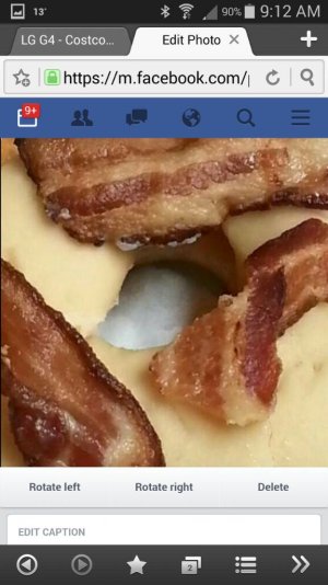

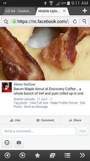

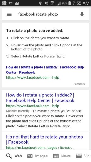

It takes just a few clicks to rotate your photo on Facebook ☺
Thanks! I don't see that option on the Android app, but I guess I could've done that on my laptop. Good to know. Regardless, hopefully these workarounds won't be necessary forever.
I don't know about the app (uninstalled long ago) but the attached screenshots are from the mobile site.

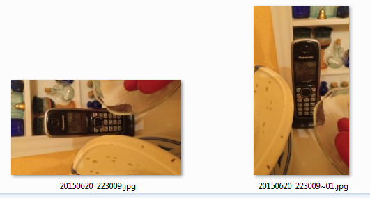

The easiest solution I've found (just now!) is to edit a portrait photo in the QuickPic editor, and just save it... no need to make changes, just save it. QuickPic will actually rotate the photo to portrait rather than rely on Exif. Look at this screenshot from my Windows:
The first shot is the original portrait photo uploaded to Windows; the second shot is the QuickPic saved photo uploaded to Windows.
I'm aware that having to edit each photo in QuickPic is less than ideal, but it works and it pretty quick. Note that in QuickPic, both photos will look identical... it's only you when look at the Exif data or upload it to Windows that you realize the difference.
