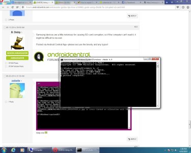

Now you will go back to the command window and type in "chkdsk" then your card's drive letter, followed by a colon and /f
It should now look something like this:
After this is typed in, hit enter and wait for the program to go to work and find then fix any corruption on the card. This can take a few minutes, depending on the amount of corruption and on the storage size of the card
When it is done, you should see this in your command window:
In this example I have no corruption, so the wait time was very short and I didn't get any reports of data being retrieved or fixed.

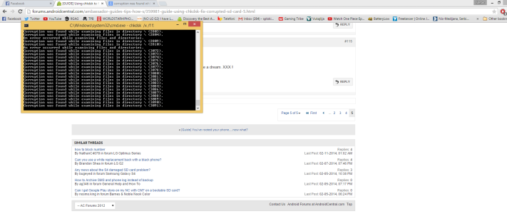

I have done all the step you have suggested and it come up with .. Unrecoverable error in folder convert folder to file y/n .... so I answered y .. and now it said it is on 78 Percent complete .. with C:/user under it!!
Hi .. I had y/n questions as well .. Unrecoverable error in folder convert folder to file (y/n ) I put y then it said 80 percent but is just still sitting there please help!!

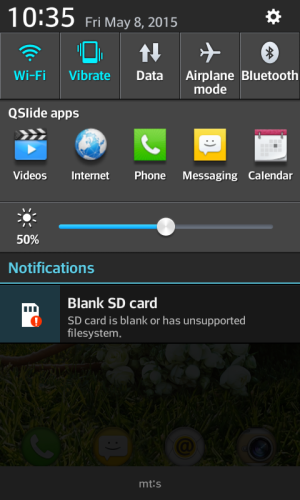

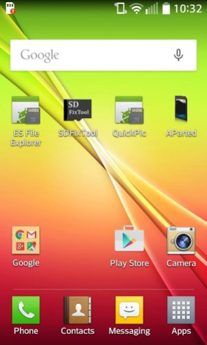

Guys i am looking to fix my problem for whole damn day am getting angry i don't have warranty i will eat it if i dont fix it in like a day or so,i have SanDisk 64gb class sdHC and lg f70 can't do s*** help me xD22s.PNG
Okay cmd finish his job,i was happy for a split second and then this... Screenshot_2015-05-08-10-35-01_1_.pngScreenshot_2015-05-08-10-32-49_1_.jpg
