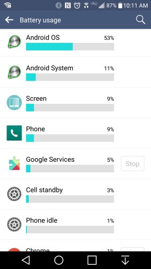

LG G4 battery drain HELP!
When I first got my G4 I was getting approximately 25 hrs per charge. I'm not a heavy user by any means. I check facebook, twitter, and instagram periodically throughout the day and don't really do any video streaming or gaming. After about a month, I started getting about 7 -10 hrs. I bought a new battery from LG and the same thing happened. A few weeks of 25 hrs then 7-10 hrs after a few weeks. I then went and got 6000 mAh battery which was awesome. I was getting 50+ hrs on a single charge. But now, 3 weeks later, I'm at about 12 hrs per charge. What the hell is going on? This doesn't seem normal to me especially since I'm not a heavy user. Does anyone have any insight to what might be happening and how I can fix this? Also, everyone once in a while my phone will be in my pocket and I can feel it heating up even though no apps are running. Any help will be greatly appreciated!

Re: LG G4 battery drain HELP!
I don't have Lookout installed. And if I go to battery usage the highest app is google services at 5%. Android OS is 53%, android system is 11%, screen and phone at 9%.

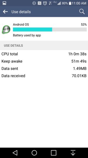

Android OS 53%? That's the problem right there. Can you post screenshots?

Wow that's really high, mine only uses about 5%, and my screen is the highest at 31% but I guess that comes down to having a great display. There must be some kinda syncing going on in the background. I know FB is a killer on the phone. I disabled that on FB and instagram
