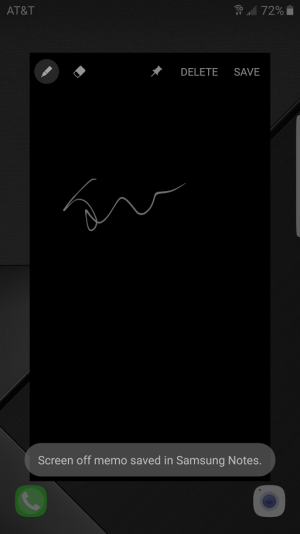

When the phone is off, pull out the s-pen and write something down and then you should have this icon on the top (the one that looks like a push pin next to delete)
After you tap that icon, put the pen back in and you should have a new notification on the always on display. Double tap it to see your pinned note.

Hmm I see the pin icon when I write notes on the always on display
Have you turned on always on display?

I'm having problems with mine. It will alow me to click on the pin icon; however, after saving it only shows an icon on my always on display that I can click twice to open the memo. I was under the assumption that the memo would just display on the screen without me having to double click on the icon to make it display. Am i wrong? If not, is there a setting I nees to change?
You are not wrong, the pinning to AoD is not working yet it appears. Not on mine, nor anyone's I have read about in these forums.

Yeah I can't get it to work like that either actually. Maybe a bug or something.

Hoping this might help others. Mine didn't work either. I could pet I could write a note but then it would disappear and just be an icon on that always on screen. Then I went into the always on settings. Once and there I clicked to change one of the clocks the colouring of it and then it said it needed to do an update. Once the update was dark and the always on memo shows now once I have pinned it.

I got an update in Galaxy Apps for the AoD today that fixed the screen off memo issue. Music controls also now show up for any music app. Pretty sweet.
