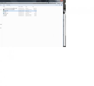

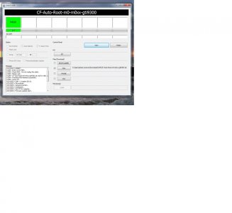

Hi Guys,
So i have an S3 which i bought in Ireland. It is GT-I9300. My phone bricked during a samsung upgrade. My device is not rooted. I can still access ODIN mode by pressing the required buttons etc.
I have tried to update the stock frmware through Samsung Kies and Kies 3 as per another guide on here but i have had no luck that way. So next i downloaded Odin and the Stock firmware to flash. I successfully completed all of the steps and it showed on the ODIN screen on my s3 that the firmware was present but it did not install and the phone was stuck in the Samsung boot screen loop. So my question is my did the firmware not install when i successfully managed to flash it using odin? Maybe it is the stock firmware i used? Can someone help me locate the proper stock firmware to use please.
Please see photos attached
Odin Mode
Product Name: GT-I9300
Custom Binary Download: Yes( 2 counts) - This is 2 as i tried it twice
Current Binary: Samsung Official
System Status: Official
Re: [Guide][Samsung] How to flash Stock ROM via ODIN
I would look at either Samsung updates or sammobile for your downloads. There might have been a download error in the file you have.
I am pretty sure i used Samsung updates, i am now trying a firmware from sammobile hopefully this will work. Is there anyway to be 100% sure your using the correct firmware?I bought the phone from a friend and it was factory unlocked - i don't know if that makes a difference.
So i just downloaded a firmware from sammobile and sent it the phone using ODIN, it transfered sucessfully and when it restarted it is still stuck on Samsung Boot Screen?any ideas?
