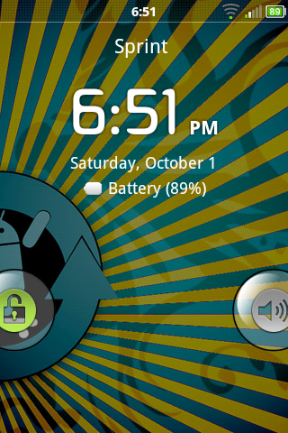

Been testing a 2.3.7 release. Notable change is that I sized the ring bubble lock for a better size for our screen.
attachment.php
