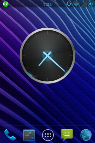

Hi Kraven! Is there a way to reverse to the original theme of the dialer? I'm using another theme but the dialer is not fully themed after applying that theme and it looks like a mix of your newly themed dialer and that from the theme I'm using. Looks kinda weird... Thanks!
Re: [ROM][WIP] CM7 Port for Optimus S by thekraven 10-23-2011
It's supposed to look like this.
attachment.php
But it looks like this
attachment.php
I've rebooted my phone after choosing the theme but it still looks broken
