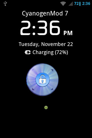

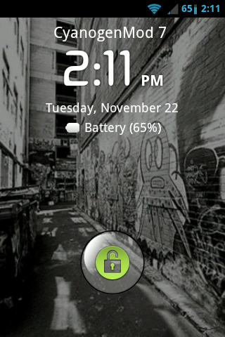

CM7 tip: New lock screen option for one Ring bubble only in 11/20 builds. Shown with the stock ring and some theming applied.
Go to : Settings > Cyanogenmod settings > Lockscreen > Style Options > Check Minimal Ring style. I'll help with theming just ask. Either by adb or Zipthemer.
Where could I find the zip for the one on the right?
Sent from my LS670 using Tapatalk
  • Like
Reactions: pergerson6
Re: [ROM] CM7.1 Port for Optimus S by thekraven 11-20-2011
It's all in the framework-res.apk . You can pull that file via adb or grab it from within the ROM zip file. Depends on your capabilities with 7zip and copy and pasting system files. And swapping out graphic png files using 7zip. Using zipthemer kind of does it for you. I haven't made the zipthemer yet. The attached file below is just the graphics that you unzip and drop into the /res/drawable-mdpi/ folder with 7zip. Then push the framework-res.apk file to your phone.
EDIT. Here is the Zipthemer file: http://www.mediafire.com/?loxiehdcfw5zob0 and minimal version http://www.mediafire.com/?zv18m8ajkpqra37..download to your SDcard. Install Zipthemer from the Market. Open the App and click the +Theme button. Then click Build it. Choose to make an undo also. Now you will have a flashable zip to flash in recovery. Don't worry about edify options with Xionia recovery.
