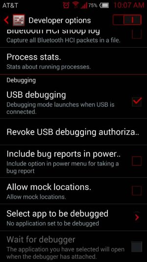

Go to settings more about device find the build number keep tapping it until you get developer options hit the back button turn on developer options go down the list and hit the revolk USB it will reset it as 4.3 has an rs a key it assigns to your computer if it doesn't read the key no access you should see a small box pop up when you reconnect it to allow it click allow and you should be able to connect

Did you revolk the permissions? And I need system data??? Os of your computer windows mac linux??
